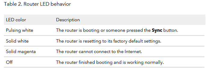

    louis_nichols wrote:
    The LEDs stay OFF all the time
    Definitely strange.  The 750 user manual says:
      Indeed. But I guess where there's room for one bug, there's room for one more.
      Maybe the router just resets the WiFi module, while the OS itself keeps running. Although, I would expect that to be a shorter operation than the durations I see.
