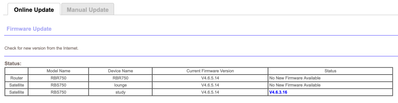

It was a painful process, but eventually I managed it, even though the router now shows me:
How a lower numbered firmware can be presented here as an upgrade I have no idea, but that's not why I posting. I'm posting because I soon discovered that my two pairs of KEF speakers were no longer on the network. I can only conclude that the firmware upgrade had somehow booted them off the network. And more to the point, I have found it impossible to get them back on the network.
