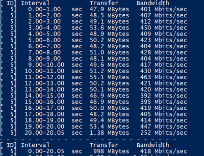

Hi,
Very interesting test indeed.
Check this out. This is consistent with the speeds I'm getting on fast.com + Speedtest (app and web, same results)
Using this argument:

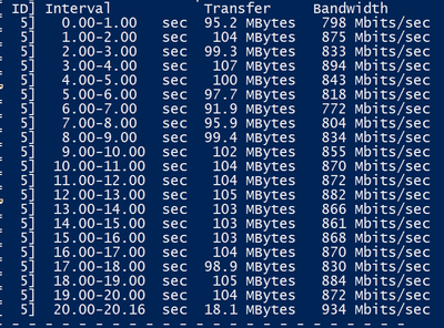

iperf/iperf3 -c remotehost -i 1 -t 20 -r Run a test from remotehost to localhost Then I ran iPerf3 with a different argument
iperf/iperf3 -c remotehost -i 1 -t 20 -w 32M -P 4 Run a test with 4 parallel streams, and with a 32M TCP buffer ... and got better results:
Not sure what conclusions to draw, or where to go from here?
