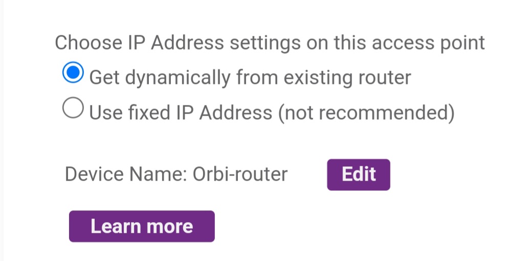

      Hi, thanks for the reply..... My orbi router is set to AP mode and configured as [attached] I cannot find the setting where I can adjust the guest network LAN settings, subnet DNS etc. Or if it's even possible. Knowledge input is very welcome šŸ™‡ā€ā™‚ļø

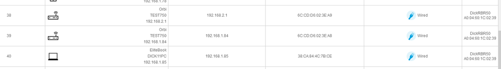

        My experience indicates that with regard to Guest WiFi, the situation is more nuanced than one might expect.
        (Spoiler Alert: Guest WiFi is NOT disabled in AP mode.)
        I have an RBR750 with the WAN port connected to my RBR50 Orbi LAN.
        • When the RBR750 is in router mode, it is assigned an IP address in the 192.168.1.x range and creates its own IP LAN in the 10.0.0.x (as it should).  It supports both primary and guest WiFi networks.
          • Devices connected to the 750 primary network get addresses in 10.0.0.x.
          • Devices connected to the 750 Guest WiFi network are assigned IPs in the 192.168.2.x range.
        • When the RBR750 is changed to access point (AP) mode, It is assigned an IP in the 192.168.1.x range, but the Attached Devices page now shows the same MAC address with two different IP addresses see image below):
          • 192.168.1.84, and
          • 192.168.2.1
        • In AP mode,
          • Devices connected to the 750 primary network (wired or WiFi) are assigned IPs in the upstream router 192.168.1.x network, and they appear in the Attached Devices display of the upstream router, but...
          • Devices connected to the 750 Guest WiFi are assigned IPs in the 192.168.2.x range.
            These devices do not appear in the upstream Attached Devices display.
        My belief is:
        • Guest WiFi network is not "disabled" when an AX router is placed in AP mode.
        • No matter what mode an AX router is in, devices connected to the Guest WiFi are assigned IPs in the 192.168.2.x range.  In router mode, they appear on the Attached Devices display.  In AP mode, they do not.
          In router mode, every device connected to the AX router is hidden from the upstream router by NAT.  In AP mode, devices on the primary network are reported on Attached Devices, but devices connected to the Guest WiFi network are hidden behind the 192.168.2.1 NAT.
