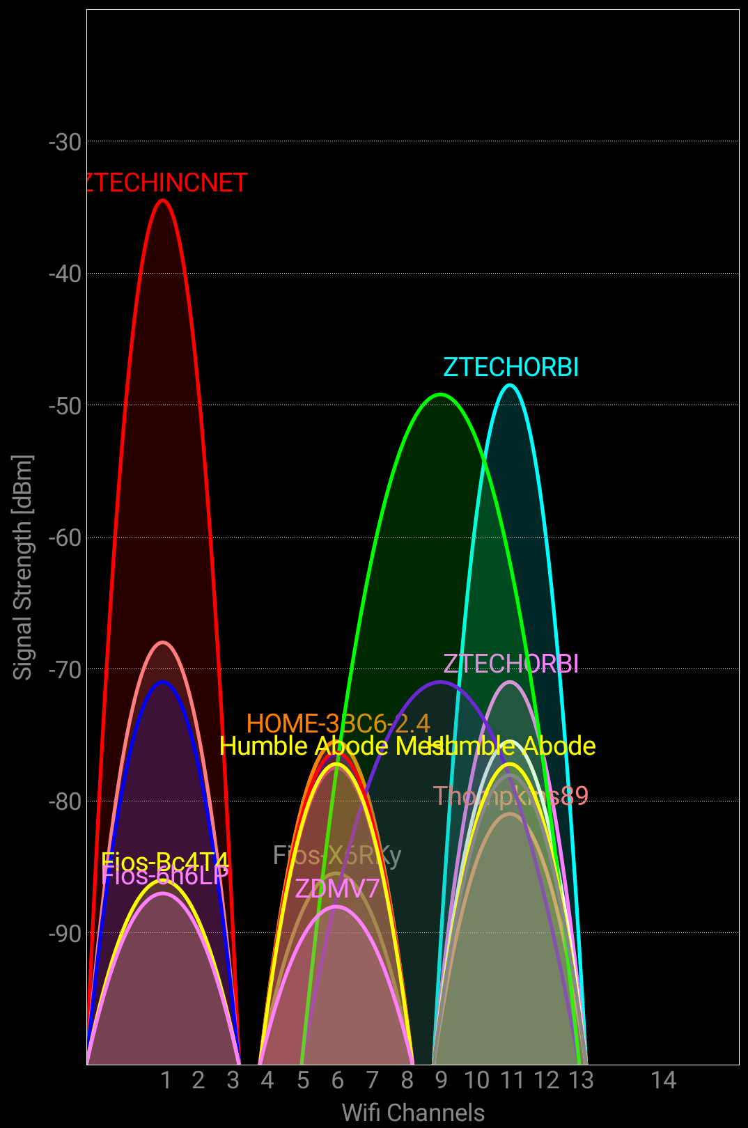

Any Wifi Neighbors near by? If so, how many? There are a few. I am attaching a screenshot from WiFi Analyzer (Android App).
