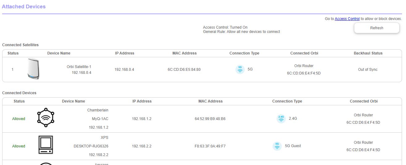

      • ScottCarRock's avatar
        ScottCarRock
        So the Orbi Satellite keeps displaying the 192.168.0.4 IP address.  I've reset the device and resync'd it with the router but it maintains the 192.168.0.4 address, see attached.  Right now it's out of sync with the router.
