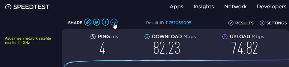

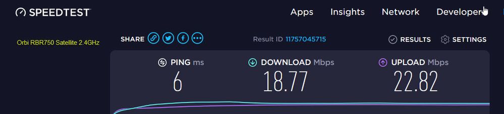

Might anyone give me any insight on the following?  I was planning on updating my home network with the Orbi RBR750 WiFi 6 system.  My existing system is two Asus routers setup in an AiMesh.  I got the ORbi RBR750 today and set it up. The two setups are pretty close to the same as far as the routers locations and the satellites are right next to each other.  So I'm thinking distance and walls really should be a problem.  I'm connecting to the satellite of both system to run the following Ookla tests (www.speedtest.net).
Asus Speed TestOrbi Speed Test

      Yes both are on at the same time.  I guess I could unplug the Asus in case it's interfering with the Orbi. It doesn't appear the Orbi is interfering with the Asus.  Looks like the pictures showed up in this post.
