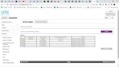

Evening all, Struggling log a support case with Netgear as posted earlier. Hoping someone can help with that but have managed to logon to Orbilogin.
Checked basics, and it says the FW is up to date but I read that there is a later version.
As you can see in the pic above, it says FW up to date on router & sat 1 but I read 4.6.8.5 is latest. Then  for sat 2, 3  and 4 it makes no reference.
Bit confused here. Anyone have any steer if I need update and how best to do. I have some other config issues to fix and ask on the RBR 850 but thought best get to latest FW first.

    Hi moonwatcher64 ,
    What 's RBR850 and RBS850 FW do you use currently ?
    Sorry, the attached picture is blurred, so I can't see it.
    And you also can check RBS850 FW via RBS850 web page.(you can connect to RBS850 via wired)

      Hi there, thanks for coming back.
      That's the problem, the RBS850's don't show any FW version at all .... on the web page or the app. The text boxes are blank and without text.
      I've managed to update the RBR850 from some age old version to 4.6.9.11.
      I have downloaded the same version for the Orbi sats but it refuses to update. I believe in reality you are supposed to update the sats first.
      But I think FW updates should be automatic in the main.When I have run the 'update check' in the past, the router always has reported that everything was up to date which it has not been I can see now.

        Yes.
        Can you log into the RBS web page and check FW version there then update the RBS to v.11 using the RBS web page?
  • FURRYe38's avatar
    What is the size of your home? Sq Ft?
    What is the distance between the router and 📡 satellite(s)? 30 feet or more is recommended in between RBR and RBS📡 to begin with depending upon building materials when wirelessly connected.
    https://kb.netgear.com/31029/Where-should-I-place-my-Orbi-satellite 📡
    I found that if the RBS are to far away from the RBR, this can effect how the FW is detected or being reported from the RBS to the RBR.
    What does the FW version say if you log into the RBS web pages?
