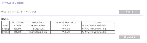

I have had critical stability issues with my network (1 x RBR850 and 2 x RBS850 in a hardwired star configuration through 1GB network switch) since around january 2022. It was working great for version 4.6.3.9, but for all following upgrades it has been unstable. I can see some periodic DNS timeouts and restoring of connectivity for my windows 10 home and pro pc's of different types.
I have tried everything from factory reset, manual rollback to version 4.6.3.9, by the way which worked great again, until overriden by automatic firmware updates. I have also checked the recommended firmware recommended for my pc's are installed.
I have spent quite an amount of money on this network and I think it's absolutely horrific that I have now spent 4 month and still have these issues.
Please help anyone? Or maybe just to prevent an override of the manual installed firmware which I know is stable.
