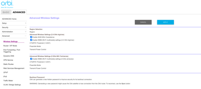

What FW is loaded on the system?
You should have this if your have v7 FW loaded:
