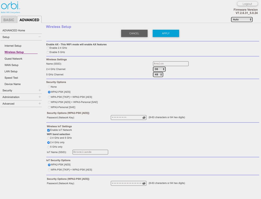

Orbi RBR850 unstable/DHCP assignment issues after reboot
Post concerns a RBR850 and 2 RBS850 satellites, all running firmware version V7.2.6.31_5.0.24.
Summary: I have to turn off all WiFi devices near the router in order to get a successful reboot where devices get an IP-address via DHCP. If I don't, devices don't get a DHCP address and get a self-assigned DHCP-address instead.
Background: I have a lot of WiFi-enabled devices. I suspect this was introduced mainly by the latest firmware that was probably installed automatically (I had auto-update on before). I cannot say for sure because as far as I know there is no log or notification when firmware gets updated, and the Release Notes of the firmware are of no help either because they don't mention the release date. My experience is: I had been adding several Wiz lightbulbs in the last week of April. Everything was working fine when I left for a trip on May 2. On May 3 I notice my house was offline in Apple Home. I asked a relative to reset the router and the Apple TV that is the HomeKit hub, but nothing helped: it stayed dark. When I came back on May 11 I started this journey to figure out what is going on.
Coming back I could not get things to work AT ALL. I discovered I had to basically turn off ALL devices in the house that had WiFi, restart the router, wait for a minute or 10 and then slowly turn devices back on. If I did that too quickly devices would not connect (I suspect not get a valid IP) and subsequent devices would then also not connect reliably. Absolute nightmare that had me at the end of my wits for 3 days. I then decided to factory reset it all and set it up anew in a more organized way.
Short summary from the top of my head:
  1. Scanned networks with WiFi-explorer and made sure I chose channels that are not having too much competition. This is a residential area with relatively large distances between the houses (next house is about 20 meters from my place). Tried to play all kinds of combinations of 2.4 and 5Ghz channels, but didn't make a big difference. Played with all kinds of tweaks on the router, no big difference.
  2. Hardwired first satellite to router. Made router connect quicker but no success neither.
  3. Named devices for ALL devices that should be online (Sonos, lights, etc.). I gave DHCP range 150-254 and organized the IoT devices below that.
  4. No big difference, so decided to set up the IoT network. Moved most devices over. Not a huge difference but at least it's organized.
  5. Decided to make IoT network 2.4Ghz only. Regretfully I cannot make the regular network 5Ghz only or assign it a different channel. seems sub optimal but not sure; this surpasses my skillset; I'm a "software guy".
Finally I discovered the ONLY way to reboot successfully in about 80-90% of the cases (which I had to do countless times because assigning a device a fixed IP only works when you apply it and reboot it) is:
  1. Turn off ALL wifi-devices near the router (computers, lamps).
  2. Restart the router and wait for about 5 minutes or at least until the final satellite in the chain says the backhaul is "good".
  3. Then turn on back my wifi-devices in my office.
Sometimes I need to do that 2 or 3 times but then it works fine. Sometimes for a few days on end. Now going 3 days already without a reboot.
I also noticed it makes a huge difference if I move the router a few centimeters (!). I'm still figuring out the optimal position now. I currently am trying to find the best position for the router. I moved the RBR850 to another room with long cables to allow me to try and find the optimum spot. By the way; I had it running fine for YEARS with the router in my office and a wireless backhaul to the satellites.
TL/DR: I suspect the latest firmware update made the router unstable and it seems to have trouble assigning DHCP addresses if wifi-devices are turned on before it finalizes its booting sequence. Assigning them IP-addresses via named devices doesn't seem to help; the devices need to be OFF. Not doing so makes the entire house fail in DHCP-assignments.

      Channel configurations:
