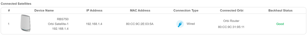

Just got a RBR750 and RBS750. The RBR in the main house works fine. But I seems to have issues with the RBS750, which is in the workshop.
They are backhaul connected via ethernet cable.
From time to time, it just drops the connection (Every 10-15 minutes). I'm perfectly connected to the sattelite (which I can ping) but I cannot ping the main router, while its lost:

The app says there is connection between the router and satelitte.
