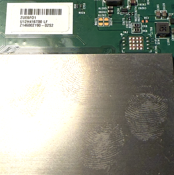

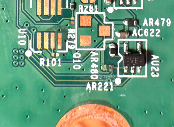

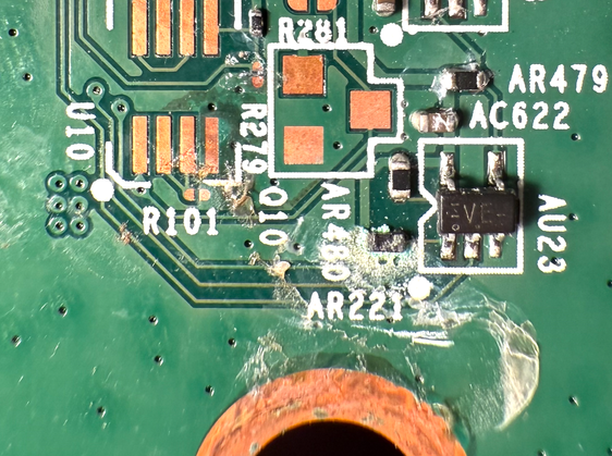

      In my case, the unit did not power on, and it appears that there was a small 'sizzling' moment in the area of the power input circuitry.
      Is that solder flux from the factory? The shiny metal heatsink has very clear fingerprints on it. I cleaned up the board and AR221 is gone.
      If anyone from Netgear reads these things, I've loaded the barcode from the Motherboard (Including Fingerprints). Could you tell me what goes in AR221? My component has rotted away.
      Or I can pull open another one that is still working and measure it!
