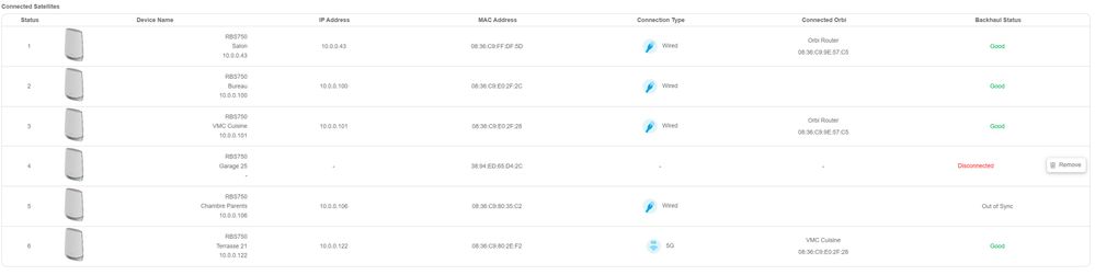

4 out of 6 are good and 2 are either out of sync or disconnected. The out of sync is using an rj45 cable and internet is working (because my nvidia shield is plugged on it) but it appears out of sync. The disconnected one is also plugged on an RJ45 cable.
Out of 6 only one is not connected by cable and it work fine.
Does anyone knows why i have this issue even though they are connected by cable?
by the way, i moved the RBS that say outofsync in others rooms and still the same issue

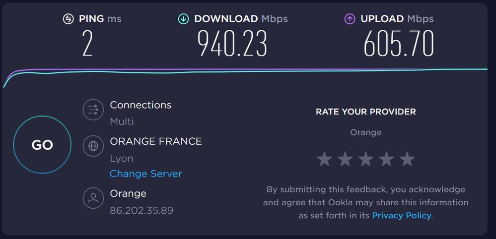

Second issue is that when i do a speed test out of the orbi RBS, i only have 100mega and not 1 giga. When i do the test on the RBR, i have giga but on the satellite i have only 100 mega.
I use cat 7 cable and my switch is giga lan. When i connect to the switch without using an orbi satellite (for example my desktop, i have the correct speed (900mgb and 600mgb). Seems the orbi  satellite are holding the speed.
