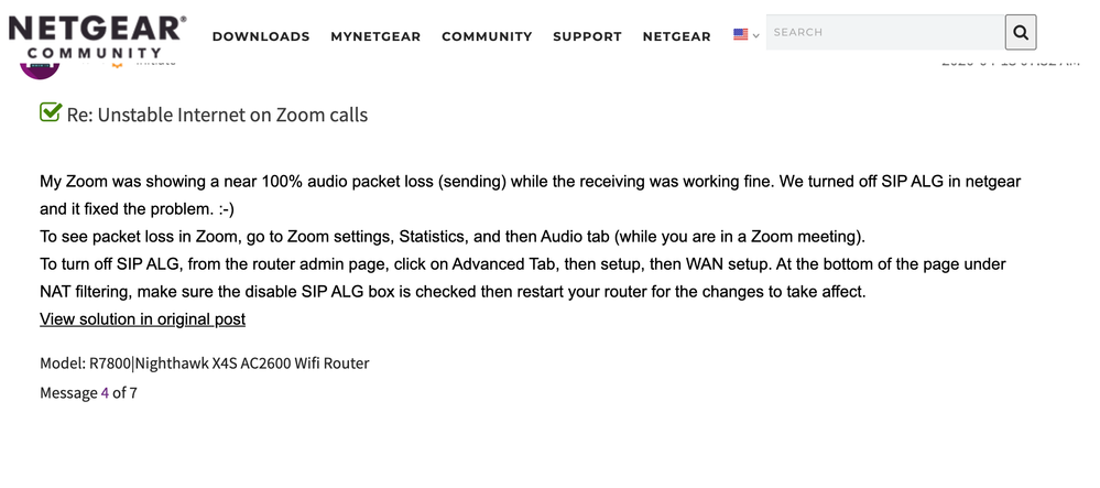

Support told me to update DNS to static and using Google (8.8.8.8 and 8.8.4.4). I have also tried disabling SIP ALG as well per Netgear community (see below). Any other suggestions?
