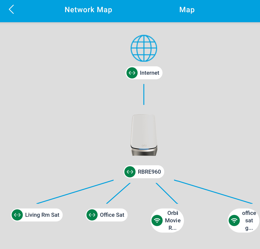

I recently upgraded my home internet to 2GB. After doing so, I purchased Netgear multi-gig unmanaged switches for the house. In order to take advantage of the higher speed, I direct connected one of the satellites to a new switch using the 2.5GB port. So the sat is on a wired 2.5GB switch, connected over local network to another 2.5GB switch on the other end of the house, that is connected to a 2.5GB port on the Orbi router, that itself is connected to the 2GB Moca modem.

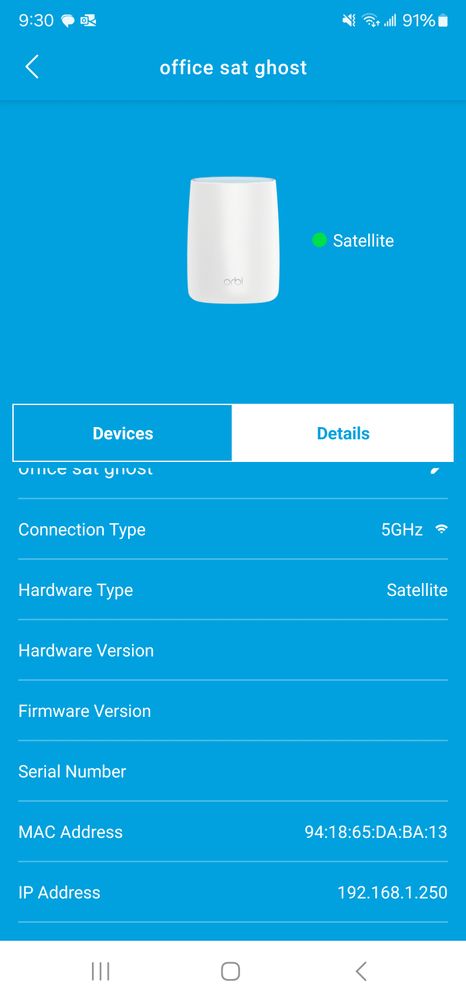

After rebooting the sat, and rebooting the Orbi router, that satellite shows as two. One wired, and one wireless that shows to be out of sync. I cannot remove the ghost wireless sat, and nothing connects to it. It cannot be ping'd and the MAC address does not match what is printed on the sat.
If i take it off the wire, the ghost goes away and the sat shows normally as wireless. It is worth noting that everything "seems" to be working ok, but I have that random sat showing up in both the app and in the browser.

Got a screen capture of this? Yes. Notice the ghost has no hardware version, no firmware version, and no serial number.

- MrJamisonAspirant
One satellite is wireless, one is connected to a 1GB switch (no ghost, working perfectly), and the third satellite is connected to a 2.5GB switch (this one has the ghost sat associated with it)
