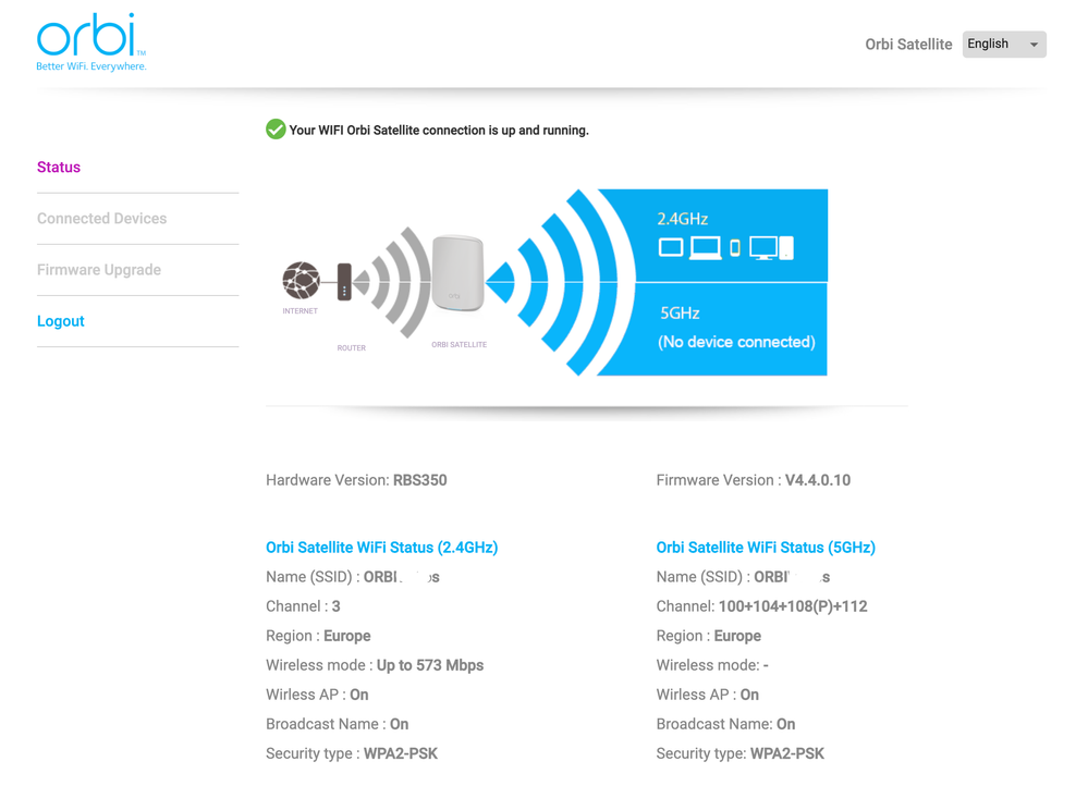

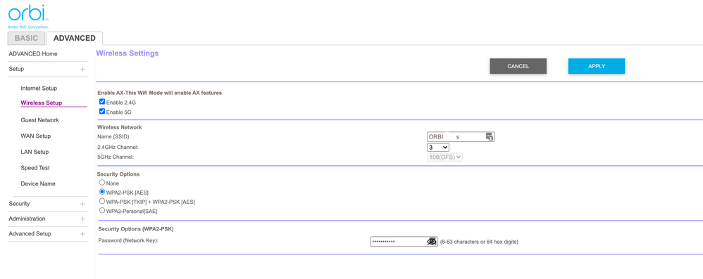

  • I'm browsing to one of the satelites using its IP. And I discovered that 2.4GHz is not working. So devices are disconnected.
    But I don't why. Orbi router has enable 2.4 and 5G.
    Any idea?
    Thanks!
    • FURRYe38's avatar
      Then check boxes next to 2.4 and 5G are for enabled AX mode on the RBR. Not enabled of the 2.4G or 5G radios in general.
      Has a factory reset of the RBR and RBS and setup from scratch been performed then check the RBS status page for 2.4Ghz?

  • The RBR is the second snapshot. It has both signals enabled.
    Now I reset the Satelite. It finished the sync and now it's working (image attached).
  • Sorry, I don't know why I can't upload images.
    I'll monitoring the satellite the next days.

  • After a few days working ok, the satellite is failing again. Image attached.
    How I can get logs from this satellite?
    Thanks!
