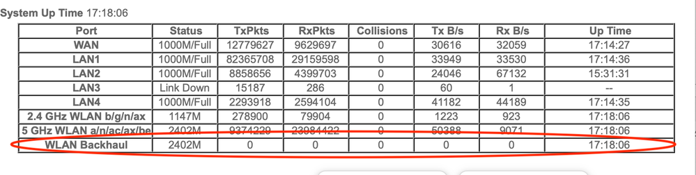

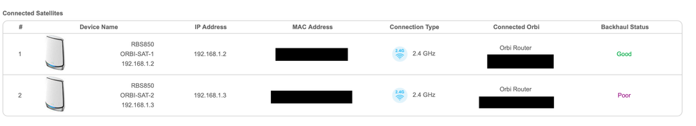

About 30 days ago, my otherwise rock-solid Orbi 850 system (RBR + 2 RBS) began to slow way down. After some troubleshooting, I noticed the backhaul was using 2.4 gHz, not the dedicated 5 gHz band and had gone from a daisy-chain config to a star mesh config. The farthest RBS ( about 75 ft from router)  shows "poor" in the connection status. I did a factory reset and a reconfiguration from scratch yesterday via the web GUI (not the iOS app). I'm still getting no signals on the 5gHz backhaul (see attached screenshot). Any ideas?

    As StephenB​ suggested, a screen shot of the satellite portion (top) of the Attached Devices web page would be helpful.
    For example, the Daisy Chain configuration may have been affected by the closer satellite no longer having a 5GHz backhaul connection.
  • I swapped the locations of my RBSs. Got the same result–no 5 gHz backhaul. After that test, I brought an RBS into the same room as the RBR, placed it about 8 feet away, and powered it up while watching the web "Attached Devices" page. As the RBS finished syncing, it initially showed it was connected to the RBR via 5 gHz with a "Good" backhaul status. Within 60 seconds of noticing that, I watched the "Connection Type" change to 2.4 gHz and it stayed there. Absolutely zero WLAN Backhaul Tx/Rx Pkts listed on the System Statistics page (As per original post screenshot.).
    Starting to think my RBR has lost ability to transmit the backhaul frequency. I used the ancient iOS Airport Utility app to search for signals. It shows the 5gHz backhaul (Ch 157) emanating from each RBS but nothing coming from RBR. Now what?

  • Refurbished RBR850 arrived yesterday. Initialized it and replaced my old RBR with refurb about 1 hour ago. Used backup config file to set up refurb and re-synced sats. After about 10-15 minutes settling time the system came back to daisy-chain topology.  5 gHz backhaul (see screenshot) is working and speeds throughout property are back to historical numbers. (Over 3X faster than when 5 ghz backhaul stopped working).
    Obviously, my original RBR had some sort of tx/rx problem in 5 gHz  band. All is good...for now!
