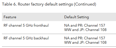

        The 350 product uses the same 5G frequency for both user facing and router-satellite communication (channel
        157 in North America, 108 in the rest of the world

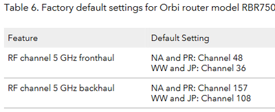

        The 750 uses different channels for user facing and router-satellite connection:
        Thus, there should be no frequency difference between connecting 350's and 750's.
