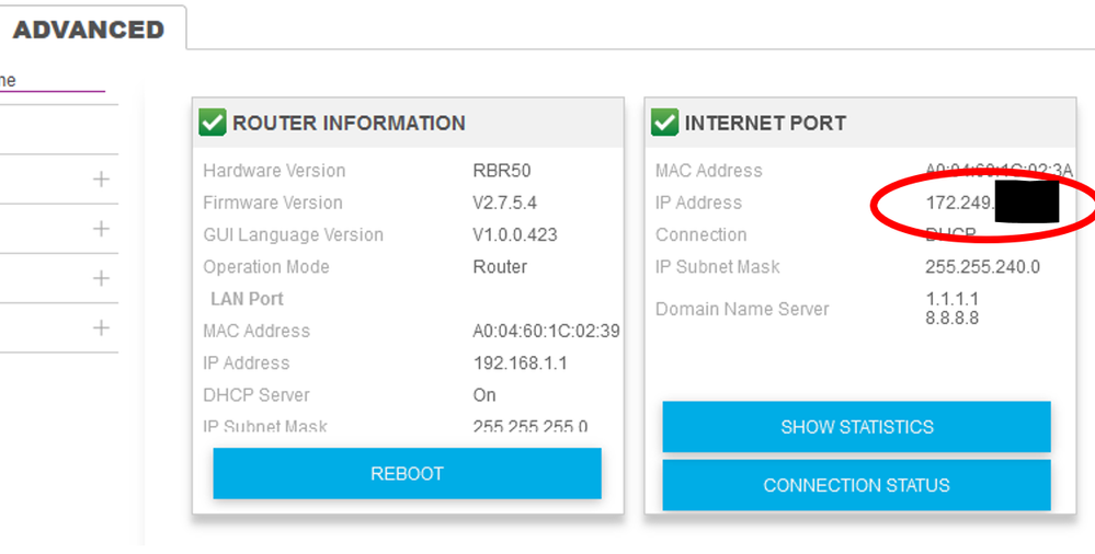

        What is the specific model number of the Spectrum device that the Orbi is connected to?
        If you look on the Orbi web interface, Advanced Tab home screen, what does it show for the first part of the Internet port IP address?

    Looks like you might have a private IP address on the RBR instead of a public IP address.
    IF you can get a public IP address, the RBR only needs to have uPnP enabled for xbox services. Port Forwarding configurations are not needed for Xbox services.
