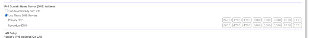

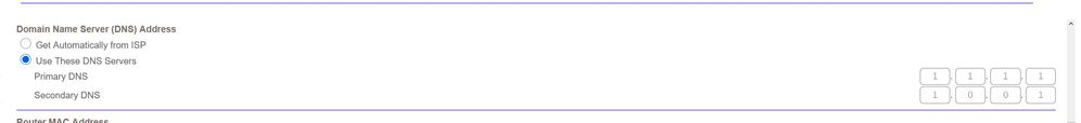

    One possible solution might be to set the Orbi to use different DNS servers than those provided by the ISP.
    I chose CloudFlare (1.1.1.1) and Google (8.8.8.8)
