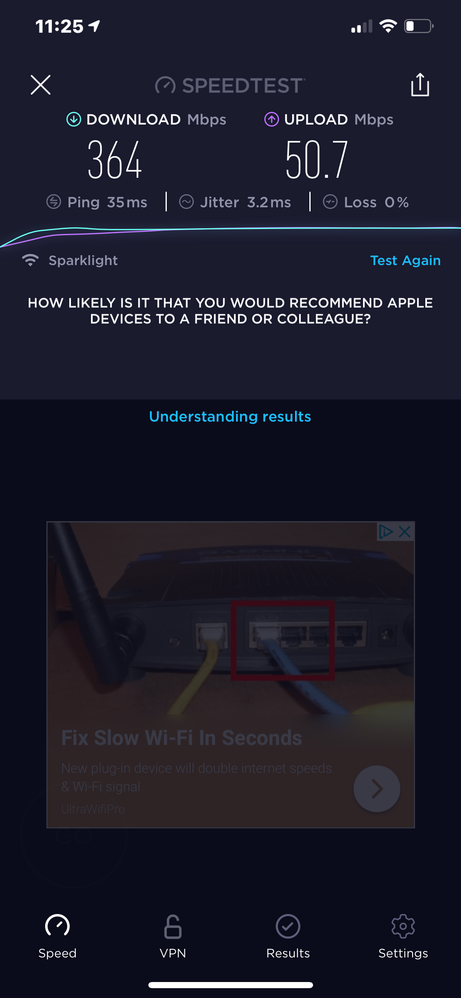

Test with a satellite in the same room as the router (AP). the satellite connected good (blue light)
1) Wired my laptop to the satellite and speedtest showed ~100 mpbs
2) Then tried wireless on the laptop. Same speed about ~100 mpbs
3) iPhone 12 Pro ~120mpbs
Not good...these satellites I know are being sold as 5GHZ backhaul which should be almost same speed as the Router
so I need the satellites on the other floors, so I moved one to the 1st floor and tested. The satellite connected good (blue light)
1) Wired laptop ~20mpbs
2) Wireless laptop ~20mpbs
3) iPhone 12 Pro ~3.4 mpbs to ~20 mpbs
This is obviously not going to work. How are these satellites supposed to achieve the speeds being advertised

What is the size of your home? Sq Ft?
What is the distance between the router and satellite(s)? 30 feet or more is recommended in between RBR and RBS to begin with depending upon building materials when wirelessly connected.
https://kb.netgear.com/31029/Where-should-I-place-my-Orbi-satelliteWhat i'm getting with my 12 Max phone using v16.6 and RBS are wireless connected:
- Cjohn7AspirantMy house is 4200 sq ft.
During my last test I only had one satellite set up on the 1st floor. I would say its at least 30’ away.
Connection to RBR was good. Speed very slow.... a crawl. Speed test sometimes would just spin trying to find nearest server.
Previous test was having satellite in same room as RBR. line of sight. Speed was only 100mbps.
Both satellites were behaving same way. So I don’t think its a defective hardware issue.
Seems the satellites just aren’t providing any strong speed even close to the RBR.
I’ve tried factory reset on both RBR and RBS and still same issue.
Thanks,
Chris- MstrbigMaster
Thanks,
ChrisCheck your network connection cable to the ISP modem. If it is CAT5, you will be limited to the 100Mbps. If it is Cat5, upgrade to Cat5e or Cat6.
The satellites are a different issue. Maybe interference. try changing WIFI channels.
