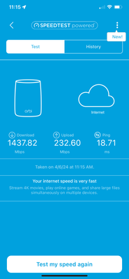

My question is obviously in regards to the download speed being bottlenecked by the RBRE960 via the LAN ports. I am getting expected speed to the router as indicated by the app testing. However, regardless of what cable I'm using on the LAN ports, I cannot seem to get much better than 500Mbps download. However, upload speeds are fine. Wifi speeds, both download and upload, are as they should be.

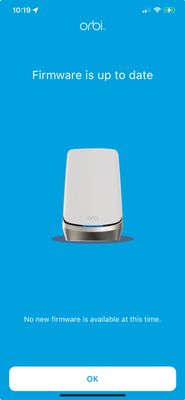

      - The FW issue is very interesting to me, because when I search for updates via the app, it tells me its up to date:
      However, I can clearly see that there is another FW update available via the link you sent me. I will look to see if I can manually update the FW and report back. Thank you for that information and links!
