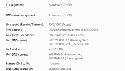

I have an Orbi 850 mesh and for some reason its only producing 90 to 100 mbps wifi and when I hook up a pc directly to the ethernet cable coming from the modem I am getting 750 to 1000mbps.
I have done a full factory reset and verified firmware is up to date.
Thank you

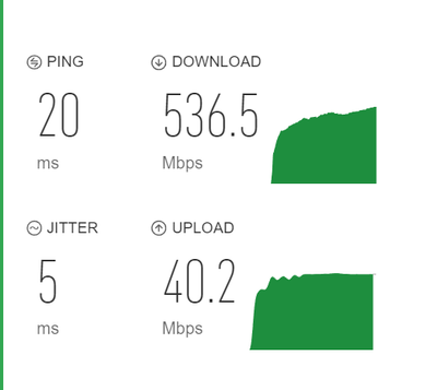

  • I changed to a certified cat 6 same results, I then connected my gaming pc and I am getting close to 500
    Still an issue with the speed but now it looks like I need to replace the orbi,
    Thank you

      I used two pc's directly connected to the router and getting 500 to 600.
      Looks like this is an issue with Orbi routers.
