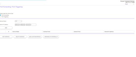

RBR660 port forwarding not showing after update
Hello, My RBR660 and 2 satellites were installed in August 2025. DNS and port forwarding were completed as well. An AUTO firmware update occurred and three things happened. The DNS got los...

- RBR660port-fwdSep 25, 2025Aspirant
Factory reset already done, forgot to mention that. FW version is Router Firmware Version V6.3.11.3_1.6.88, upper right of photo.
Different browser listed as well in OP.
Same problem with chrome as well
