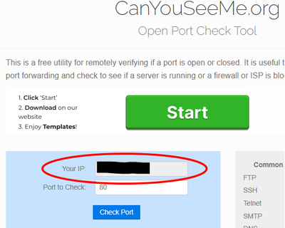

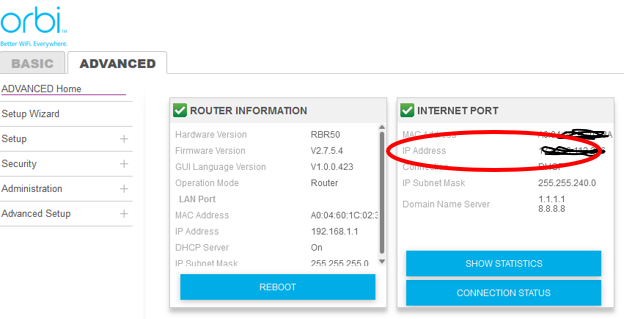

The "devil is in the details". With port forwarding, essential steps include confirming that the router actually has a public IP address. Compare the IP address shown on the Orbi web administration Advanced Tab (in the upper right box)
with the IP address shown by a web port scanner, such as https://canyouseeme.org/
If they match, then the router has a public IP address.
Then confirm that the port are not only opened, but that they point to the correct device on the LAN by entering the port (or ports) that have been forwarded and verify that CanYouSeeMe reports the ports connecting to the device.
