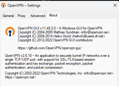

    Which version of OpenVPN is installed on the Windows laptop?

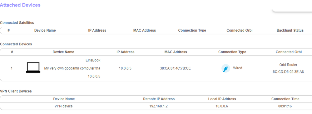

    Are you able to open the router web admin page using a device connected to the Orbi LAN and open the Attached Devices page?  When I do that, the device connected over VPN appears (usually at the bottom of the list) and shows as connection type "VPN"

      OpenVPN vv2.6.10
      I can view the connected devices, but there are no devices listed as connected to VPN.

      Thanks.  I just connected a Windows 11 PC to an RBR750 running OpenVPN server.  Here's how my Attached Devices screen appears on a computer connected to the RBR750 at IP 10.0.0.5 (sorry for the device name. I was confirming how many characters long a device name can be.)

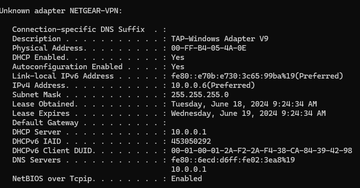

       Notice the VPN device appears with local IP 10.0.0.6.  To confirm this, I opened a command window on the VPN computer and displayed ipconfig /all
      This confirms that the remote computer connected via a TAP adapter (the goofy default for Windows connections) and was assigned 10.0.0.6.  Opened a web browser to 10.0.0.1 (the RBR750 LAN IP) and it shows the same situation.

        This is the version of OpenVPN running on the remote computer:
