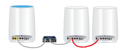

Just installed a new 850 kit w/1 * RBR850 and 2 * RBS 850's.
RBR are connected to the Cisco Gb switch
RBS #1 are connected to the Cisco Gb switch
RBS #2 are with wireless only placed on 2.nd floor strictly above RBS #1.
RBS #2 would not expect to "see" (or be VERY poor) the WiFi of RBR.
Note: with RBS #2 powered off, I have 3 of 5 lines coverage on my phone in the 2.nd floor.
My question 1:
Should RBS #2 wirelessly get its backhaul via WiFi from RBS #1 ?
My Question 2:
Are this allowed and will work as a wired backhaul for both RBS?

    1. the RBS have their own internal algorithm that determines which to connect to. Because going through a satellite might add latency and slow a satellite down a little bit, even though its further, the RBS might be connecting to the RBR. I don't know what their internal algorithm is. I just know sometimes they connect it unexpected ways
    2. you can daisy chain the satellites how you pictured.
