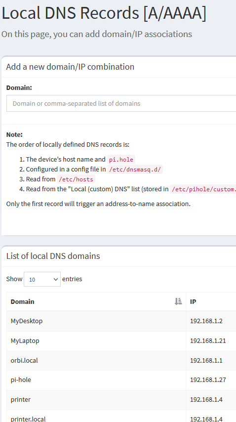

        Alas, Orbi routers DNS do not resolve "local hosts", much less automatically add devices to a table.  It appears there are only two work arounds:
        • Create host files on local machines.  (Probably not very many will need a host file. 99% of the devices in the home do not even have a user interface.)
        • Point the Orbi DNS at a local DNS server which has the capability. Pi-hole, for example, provides the ability to create DNS records and CNAME records.  Here's a sample:
