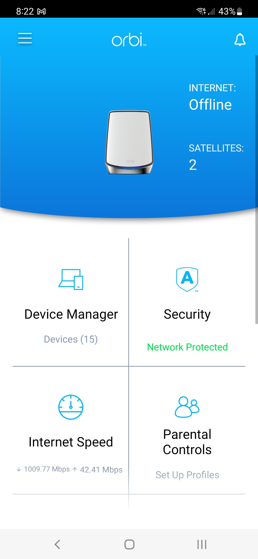

As of today, according to the Orbi app, my router keeps losing internet connection. However, the satellites show "green dots", and many of my devices have internet connectivity via WiFi. However, some devices are not connecting, so this issue is different from the symptoms I was seeing with the app before ChristineT worked to push the V4.6.8.2 firmware update last month. Power cycled my Netgear modem and the Orbi router, but the issue remains. No outages or issues with my Xfinity 1.3 GB service are reported in my area. Help, please!

EricavH22 wrote:
As of today, according to the Orbi app, my router keeps losing internet connection. However, the satellites show "green dots", and many of my devices have internet connectivity via WiFi. However, some devices are not connecting, so this issue is different from the symptoms I was seeing with the app before ChristineT worked to push the V4.6.8.2 firmware update last month. Power cycled my Netgear modem and the Orbi router, but the issue remains. No outages or issues with my Xfinity 1.3 GB service are reported in my area. Help, please!- In answer to your many questions...
I have a Netgear CM2050V modem in between the coax line and the Orbi router. The satellites are more than 30 feet away in my 6000 sq.ft. house (with wifi coverage extending beyond that to cover Ring cameras outside). This setup has been in place for over a year, with no issues before the firmware issue from May. The initial setup was done by the BesttBuy geek squad, and I don't believe they did anything special with the settings.
I did power cycle both the modem and router (but not the satellites) yesterday by unplugging for over 10 seconds. I did this after the firmware push as well.
I have no idea if any neighbors are running Orbi systems.
I did update the Orbi app (routine update from Google Play) with no change. One screen shot attached. You can see full wifi-6 connection on my phone, despite the app indicating offline. I also did a speed test yesterday (again while the app said I had no internet), with the results as shown. App shows only 17 of 39 devices connected as of this morning (my phone not included in that list, so I know that list is not accurate).- ekhalilMaster
Please login to the web interface (orbilogin.com) >> Go to ADVANCED >> ADVANCED Home >> INTERNET PORT >> CONNECTION STATUS.
What information do you have there when internet is ok, and similarly when the internet is not ok please?
