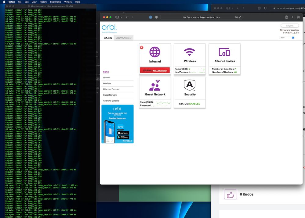

A little while ago, feels like after the V4.6.9.11_2.3.5 update, I started seeing bad network performance. My RBR850 would announce that "WIFI connect is lost" a few times a day. Ping test to apple.com has more request timeouts than ping.

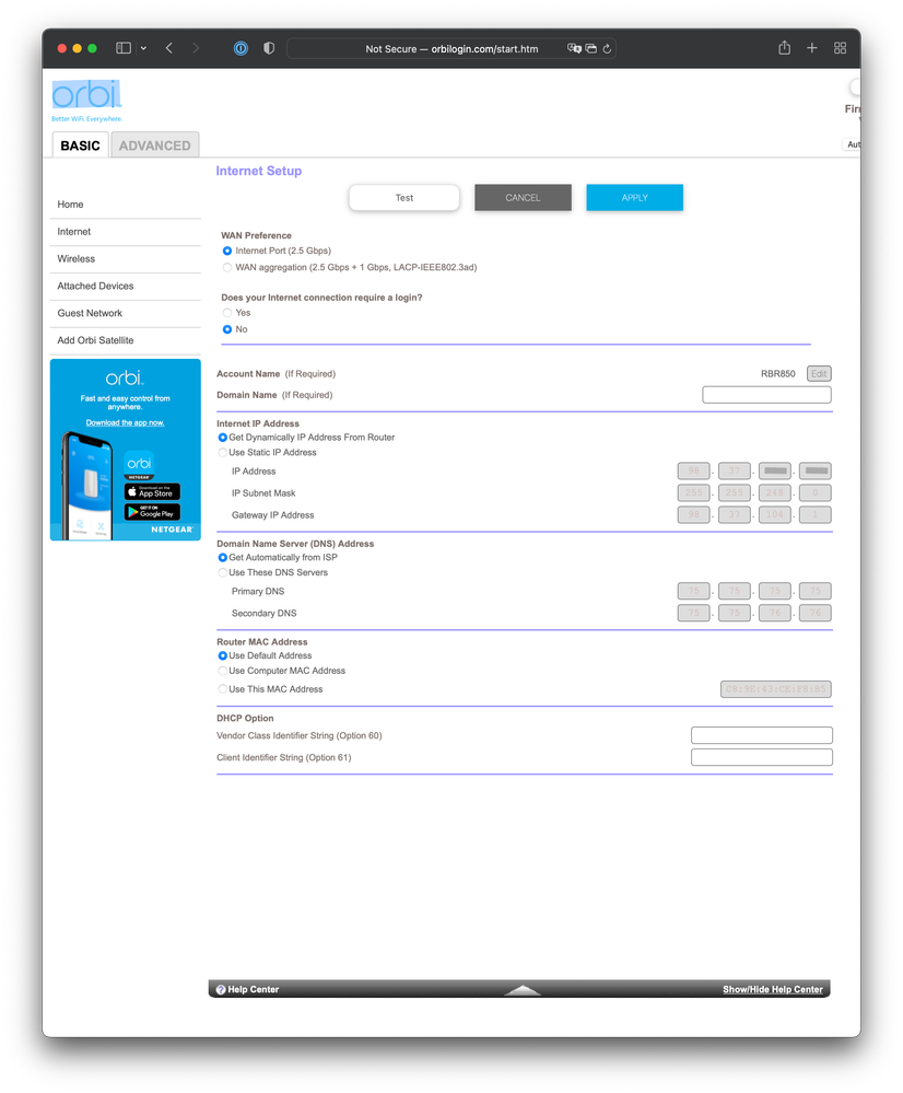

Internet -> Xfinity modem (XB7-T Bridge mode) -> RBR850 (AX6000) -> 24 port unmanaged switch (JGS524NA) -> 1 Satellite (hard wired) -> 1 Satellite (WIFI).

Thanks for the suggestions. Disconnected, re-added and re-synced both satellites successfully. Same issue, ping is showing a ton of dropped packets. I felt like I ruled out the satellites when I turned them both off and issue was still happening.
So are you pinging a ISP IP address or something?
How are you pinging?
This is with ALL other devices disconnected from the RBR including the RBS and just a wired PC pinging?
Please edit out any ISP WAN IP addressed from screen captures.
