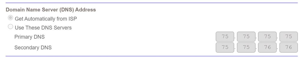

RBR850 Unable to set custom primary and secondary DNS servers
I recently noticed that my Orbi home network was no longer using "Open DNS" DNS servers as I had configured it a few years back.  I am not sure on when this changed.  To troubleshoot, I went into the Advanced -> Internet Setup page on routerlogin.com and noticed that the Domain Name Server (DNS) Addresses section is grayed out, with "Get Automatically from ISP" checked.  I am unable to select "Use These DNS Servers".
Does anyone have any idea how to configure overrides for primary and secondary DNS servers?  Earlier today I upgraded manually to the latest firmware and performed factory resets on all my Orbi devices, just to see if it helped, but the problem remains (grayed out option).  Any thoughts?
I have provided a screenshot of the relevant section below.
Thank you!

  • I think I saw this before on my router. It can be that it's just "stuck" there. Try to just check the previous section "Internet IP Address" to "Use Static IP Address" and back to "Get Dynamically". I think then the DNS selection possibility will open. 🙂

      Hello, thank you for your thought.  I have tried your suggestion but the options remain grayed out.

    Is Armor or SPC enabled? If so, disable these and try again?

        How does one disable SPC?
        In the Orbi app, go to >> Click left upper side of the app >> SETTINGS >> Parental Control >> Disable Parental Control
