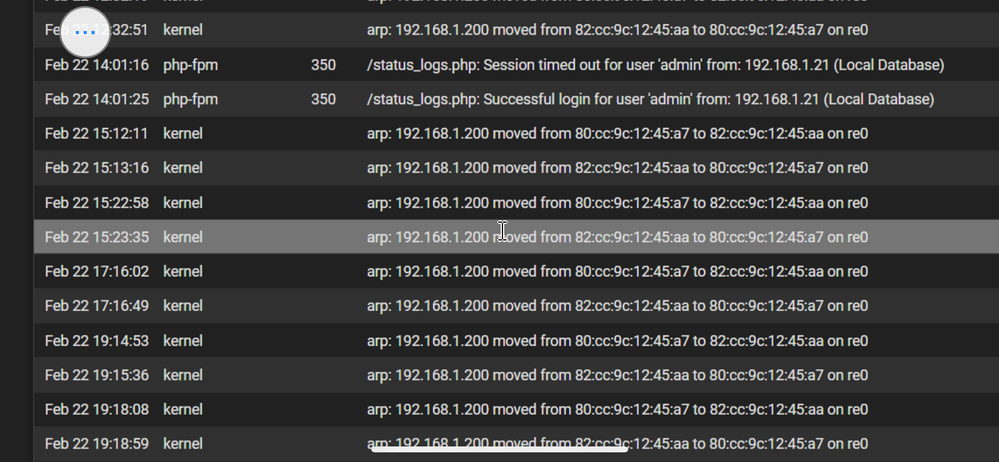

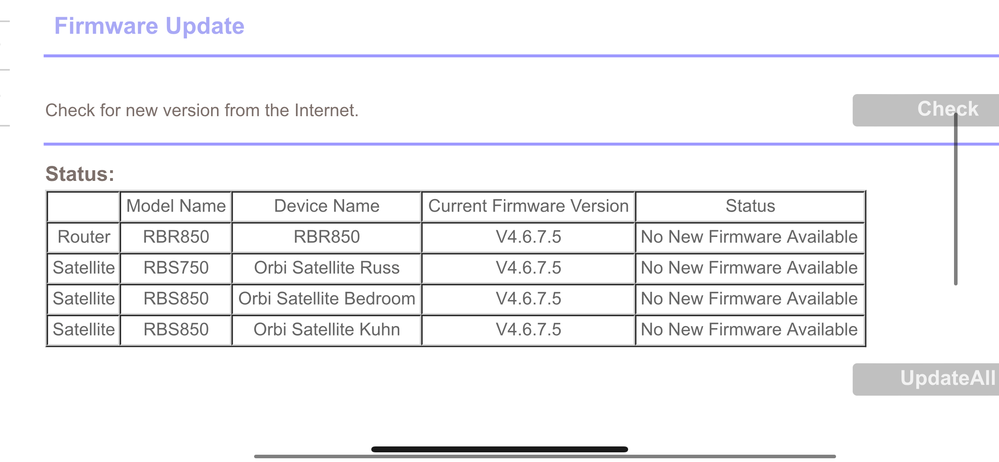

Howdy y’all. I have an Orbi RBR850 with 2 wired RBS850 and 1 wireless RBS750 satellites. All satellites work but one of them seems to randomly switch from wired to wireless mode randomly. I’m assuming that’s what is happening based on my pfsense logs. The Mac switches back and forth. The max ending in A7 is the wired MAC according to the Orbi pages. All firmware is upgraded. Any suggestions?
Orbi (all devices) V4.6.7.5

Connection is as follows:
ATT Fiber Modem to pfSense WAN0.
pfSense WAN0 to LAN0 (Realtek with updated firmware dual card in pfSense machine)
pfSense LAN0 to Orbi RBR850 WAN Port. (Orbi setup in AP Mode)
RBR850 WAN Port to Orbi RBR850 Internal Port
Orbi RBR850 Internal Port to Netgear Unmanaged 10/100/1000 Switch
Netgear Unmanaged 10/100/1000 Switch to both RBS850 Satellites
