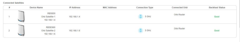

      The connection between the 960 and 850 is via wi-fi, I just added a satellite and it worked.
      Looking at the 850 panel I see two satellites
      • CrimpOn's avatar
        CrimpOn
        Thanks for the screen shot.  From my perspective, it appears that Netgear's compatibility information deserves another footnote.
        (who knows, maybe the 850 satellite is also 'compatible' with the 960 router as well? - except for the obvious feature differences.)
