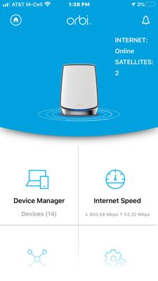

      Thank you for sharing your experiences.
      Yes, v10.11 breaks RBS connections to the RBR while in AP mode if a LAN switch is used between. All other versions of FW prior to this version, AP mode works with LAN switches. I have already filed a bug report on this.
      Initially I could not get the orbi app to connect correctly to the Orbi in AP mode. However when I selected the thumbprint next to the "admin" long in name. Then it log in correctly. I might have not input the correct passwored when i manually typed it in. However the Orbi app is working here on my iphone connected to my RBR850 in AP mode behind a R7800 router.
      I haven't used Guest Network. I normally don't.
      Yes, we all hope NG does get this fixed upon next release.
