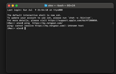

  • Guys, just look at this screenshot.
    But if I connect a VPN connection, then everything works fine!

      When I try to access the site, I get a message from the browser
      hmm. We're having trouble finding that site.
      If you entered the right address, you can:
      Try again later
      Check your network connection
      Check that Firefox has permission to access the web (you might be connected but behind a firewall)
      (This happens in all browsers)

        Just crazy.
        • Connect using WiFi, web browsesr load the site.
        • Connect using Ethernet, web browsers all cannot find the site.
        On Windows, the WiFi adapter and Ethernet adapters have separate settings for how they determine DNS servers.
        (using DHCP to be told which server to use - which is usually the gateway router {Orbi}) or
        DNS servers defined by IP address.
        Does it work the same way on Mac?
