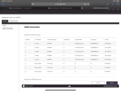

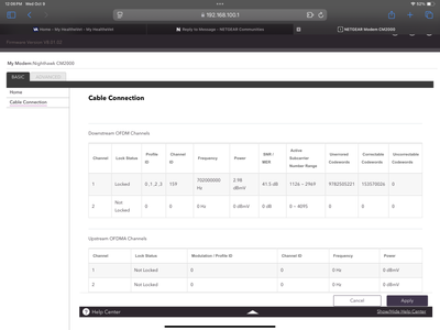

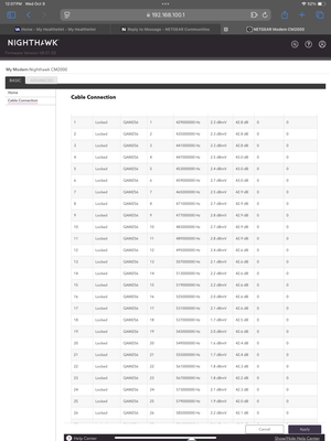

      Modem info:

        Can you post the Event logs from the modem as well please.
        Other modem logs look good. No issues there.

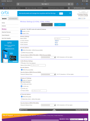

        For that size of home, Just the RBR and one RBS is needed and I'd turn down the power on the RBR to 25%. Under Advanced Tab/Advanced Settings/Wireless Settings
