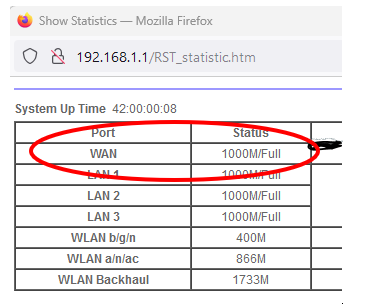

    My first step would be to look at the Orbi web interface, Advanced Tab home page, and click the Blue Box Show Statistics.  It should look similar to this:
    If the WAN port reports 100M/Full (rather than 1000M/Full) then the modem and the Orbi have determined that the highest speed they both support is 100Mbps.

        What does the speed look like on the RBRs web page under Advanced Tab/Show Stats/WAN port. 1000mbps or 2500Mbps should be seen here.

      thank you for this response i did check the statistics and it is in fact showing only 100 Full on the WAN port. soi called my isp and it is in fact their Modem so thank you for all the help.
