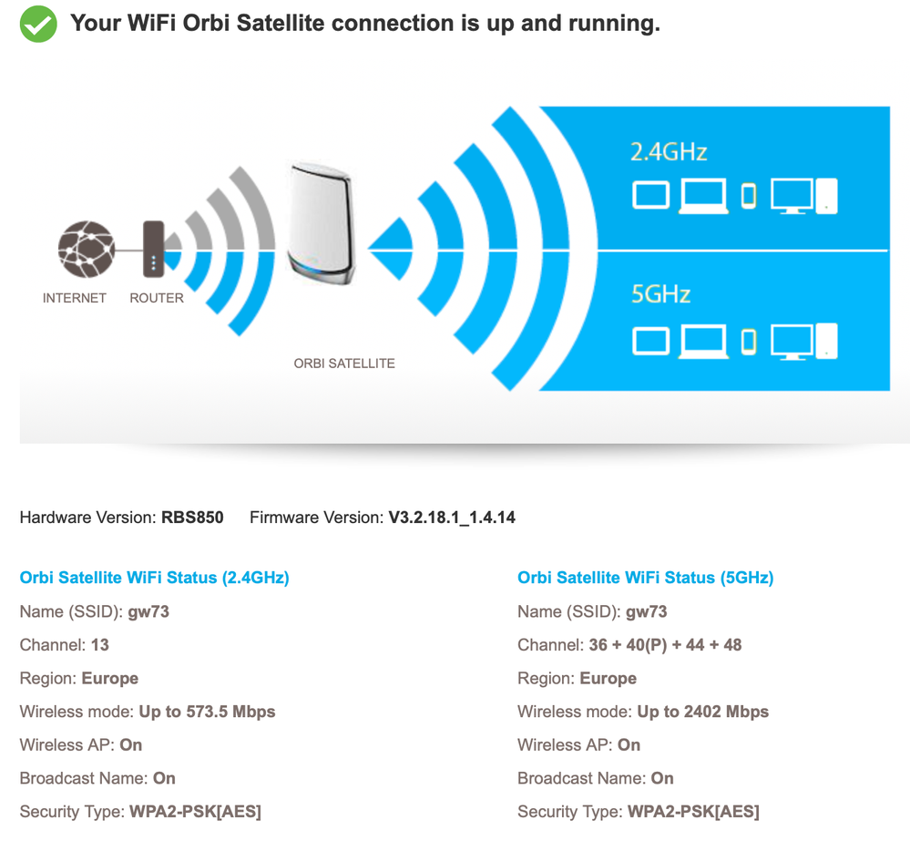

i have a RBK853 system installed in my home running in AP mode...behind a web-router from my ISP(3 webgate). On the RBR there is also a lan cable connecting my wired computers. Firmwareversion of the RBR is V3.2.18.1_1.4.14

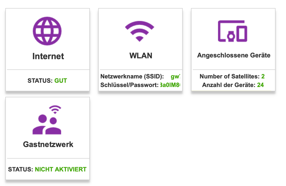

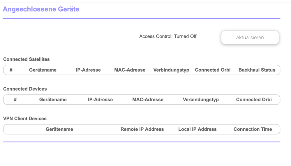

The RBR850 shows in the status page 2 satelits and 24 connected devices...but if i click the button to show the devicelists it is empty... also no satellit is shown.

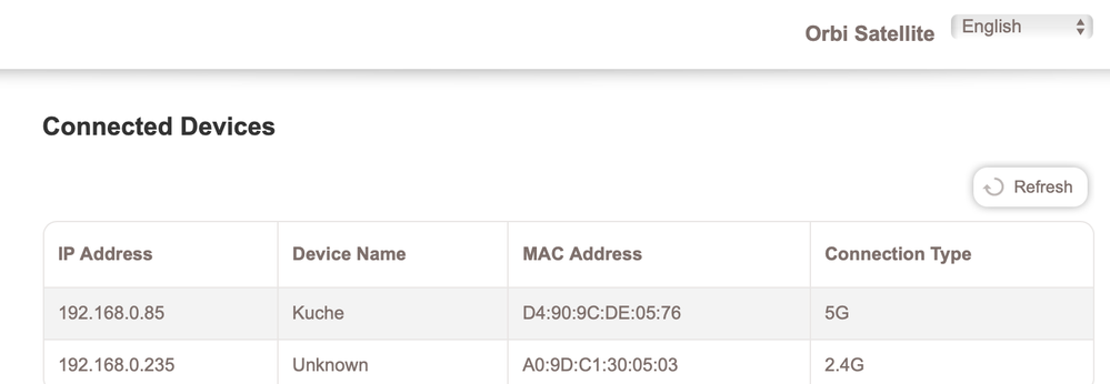

If i login to the satellits directly i can see the connected devices.
Does anyone have seen this or know what could be the reason?
