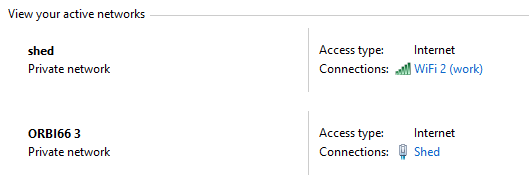

      By the way, your use of the term "private network" might be misleading. It could refer to Windows and its designation of public and private networks. Windows has a habit of using "public" network settings. These limits what you can do on your network. It can help to tell Winows that you have a Private network.
      Change from Public to Private Network in Windows 7, 8 and 10 Windows 10
      Tip: How To Change The Network Type From Public To Private | Bruceb News

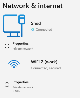

      In Windows 11 it looks like this:
      or in Control Panel\Network and Internet\Network and Sharing Centre
