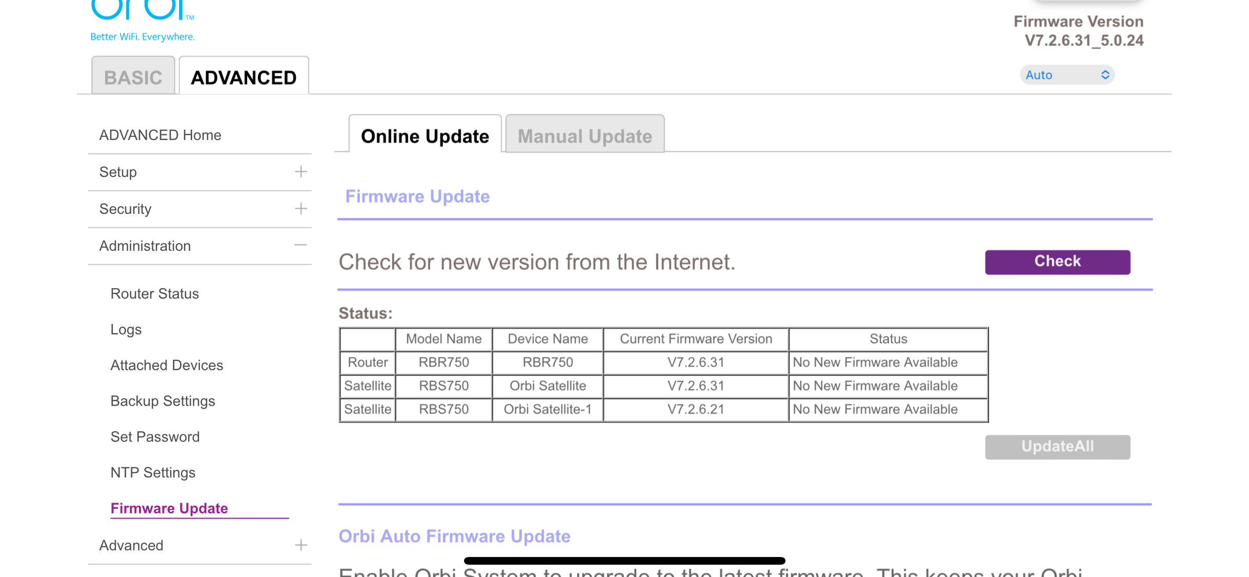

      But i successfully recovered the satellite by using Nmrflash utility. I used latest V.31 to recover. My satellite now connected to router and network. My home devices are connecting to this satellite. However the version showing is still V.21. From Orbi app and web console. I checked for update and shows no new update. My other device at v.31 and this one is still on v.21. Why is it like this? I am afraid to manually update. If the firmware again corrupted, ?

        If you can get to the RBS that has v.21 on it and access it web page, then manually update to v.31 by downloading the RBS FW file and sending the .CHK file to the RBS web page.
