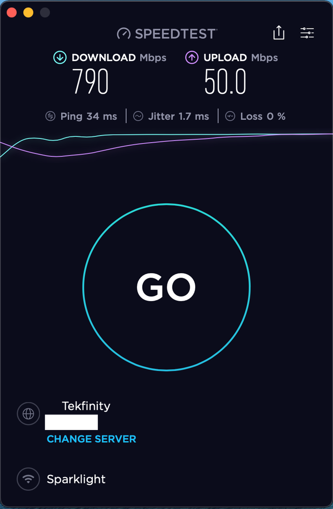

      Just checked mine when I got home. 1Gb/50Mbps ISP service.
      v1 FW.
      Manual channels 11 and 48.
      40Mhz only.
      CTS 64
      Armor and Traffic Meter not enabled.
      WMM enabled. Preamable Mode: Auto
      Mac Book Pro 2018 placed near the RBR, 4 ft:

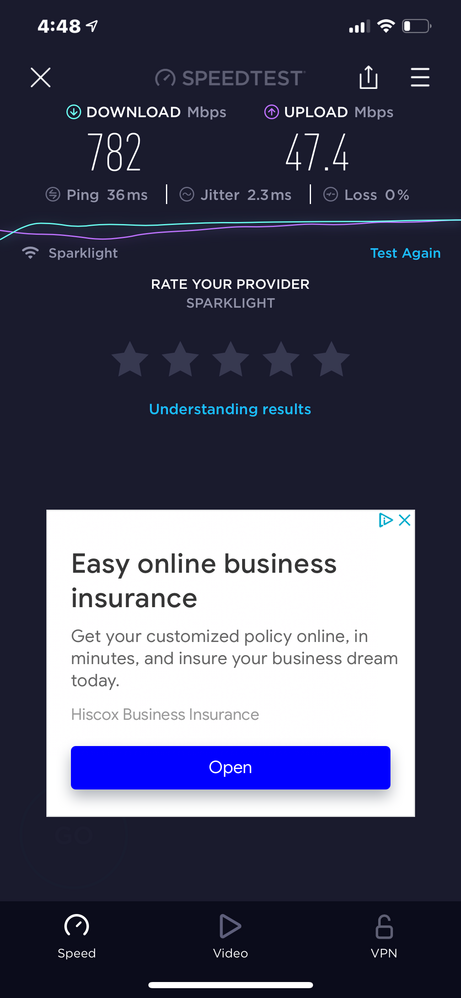

      Checked my Iphone 12 Max as well:
      Pretty good for sitting right next to the RBR. I presume as distance gains in between the devices, speeds will have some degradation which is to be expected.
