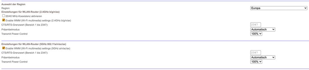

Hardwareversion RBR850 Firmwareversion V4.6.3.16_2.0.51 GUI Sprachversion: V3.0.1.2_2.1.30.3 Operation Mode Router As you see I have followed your advice and also changed to channel 48 for 5GHz. 2.4 I still use auto.

The jpg has not been send, let's try this way:
Auswahl der Region
Region:
Europa
Einstellungen für WLAN-Router (2.4GHz b/g/n/ax)
20/40 MHz-Koexistenz aktivieren
Nein
Enable WMM (Wi-Fi multimedia) settings (2.4GHz b/g/n/ax)
Ja
CTS/RTS-Grenzwert (Bereich 1 bis 2347):
2347
Präambelmodus
Automatisch
Transmit Power Control
100%
Einstellungen für WLAN-Router (5GHz 802.11a/n/ac/ax)
Enable WMM (Wi-Fi multimedia) settings (5GHz a/n/ac/ax)
Ja
2347
Präambelmodus
Automatisch
100%
