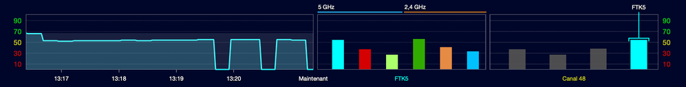

I've tried Wifi Explorer to find the best suitable channel and noticed the drops (if they are indeed the drops)
