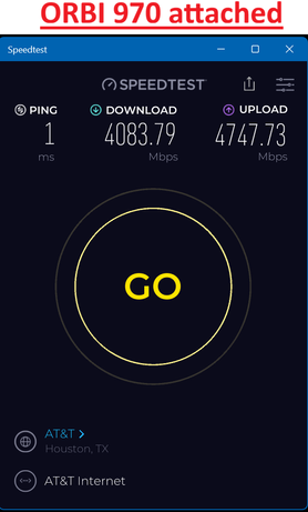

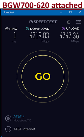

Set 970 to AP. Reset BGW to factory defaults (no passthrough). All Wife disabled on BGW and DCHPS set to Fixed. Rebooted both. Performance results no change on 970. See below.
Access Point Results
Gbps - DOWN UP PING
BGW 5327 5331 1.2
970 4604 5299 1.3

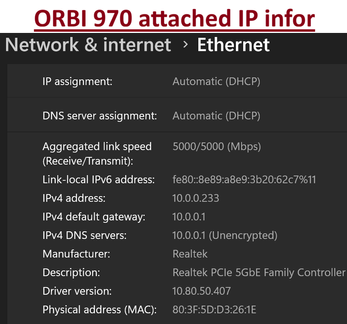

- WRSORBIJul 25, 2026Luminary
Tested with PC installed Ookla app, direct connect to router, latest Realtek driver:
