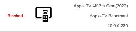

      What I am saying is that for a brief period last night, I had the option to do this. The option clearly stated - "Block from connecting to this device." I enabled the block for the Apple Tv on that satellite. Clearly it did something. The Apple Tv, in the app is connected and not blocked while the Web GUI shows the device as blocked. This is the key to my issue - the device is in fact blocked, but cannot be unblocked without the UI I saw last night. This isn't as simple as connecting to the wrong satellite or to the router.
      Web Admin:
      App:
