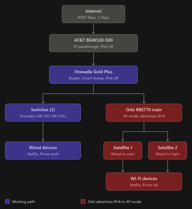

My BGW320 is set to passthrough to my ORBI RBE770+2 satellites...
Clients on Orbi Wi-Fi receive an IPv6 default gateway from an Orbi unit (fe80::ca10:2fff:fe40:e8a5, MAC C8:10:2F:40:E8:A5), an fd2a:7f4:ca8c::/64 ULA prefix, and an IPv6 DNS server fd2a:7f4:ca8c::1. The Orbi should not be doing this in AP mode. Samsung TVs on Orbi Wi-Fi fail Netflix (NW-2-5) and Prime Video. The same TV wired directly to the Firewalla streams fine. IPv4 is correct on both paths.
No IPv6 setting is visible in the Orbi web UI in AP mode. Firmware: V12.1.7.23
How do I stop the Orbi from advertising IPv6 in AP mode?

      Thanks for your interest in helping me with my connection struggles...
      I am not very smart, but I am trying.
      this is the setup
      I am wanting to use the Firewalla to get rid of the bufferbloat that is creating some caos during work calls at home...
      If I put the Orbi in Router mode, together with Firewalla in router mode as well, all seem to work. But then I get double NAT. And Firewalla can't control each and every device, it sees the Orbi as the "main device" and I can't set rules of priority to the work devices.
      Smart Queue doesn’t work when the Firewalla is in bridge mode, as far as I understand.

  • Thank you all for your replies.
    I understand what you meant about the devices generating their own IPv6 addresses.
    I just can't understand and fix the reason. While the Orbi is in AP mode, I can't use some features on some devices and as soon as I have it set to be in router mode, all flows nicely... to some extent...
    Since the IPv6 doesn't add much to my day-to-day, I will leave it off on all the internet broadcasting devices.
    What I am really trying to fix is to have the Orbi in AP mode to have the Firewalla controling the flows and help me with bufferbloat... and it seems I can't do it... even trying to use I is not helping me much. If only Netgear would include some sort of SQM in their software, it would be awesome...
    Thanks again!
