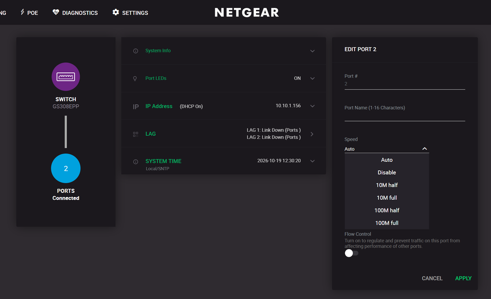

    By rule of thumb, all Netgear switches with Gigabit ports can be configured to 10 Mbps-half. For example GS108EPP:

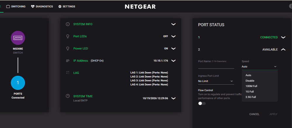

    This does not apply to the MultiGig and 10 GbE models - very similar to the Orbi 8 and Orbi 9 Series - where both auto and manual (where avaiulable) config is limited to 100M Full, 1G Full, 2.5G Full:
