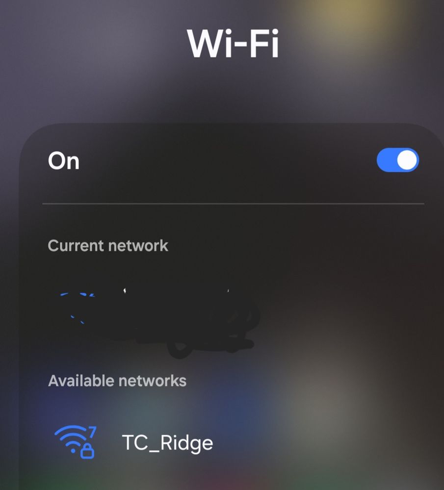

Here is a screenshot of my available networks. TC_Ridge is my home network and as you can see it shows wifi 7 in the upper right hand corner. But when I connect it changes to wifi 6.
Any thoughts on that?
Has it shown the "7" WiFi symbol when connected to other systems?
- GregS_from_MIApprentice
I haven't noticed that. But Samsung said my Galaxy S24 Ultra is wifi 7 compatible.
Just FYI, the S24 is NOT WiFi7 compatible, it's WiFi6E comaptible:
https://www.gsmarena.com/samsung_galaxy_s24-12773.php
The S25 was the first WiFi7 device to appear to support this feature:
https://www.gsmarena.com/samsung_galaxy_s25+-13609.php
And I do have a S25 and it does connect at WiFi7 on my 370 series currently in AP mode.
What security mode is set on the RBR? Should be WPA2 and WPA3.
Also what firmware version # is loaded on your system?
