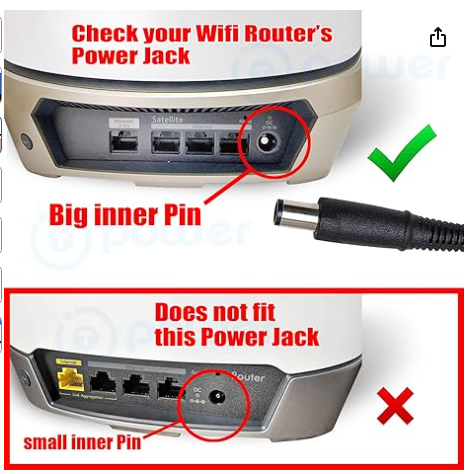

  • CrimpOn's avatar
    CrimpOn
    It would have been helpful if the Original Poster (OP) described the reason for asking the question.  I have a suspicion that perhaps the intent is to purchase the system in the U.S. but then at some future date relocate it to a part of the world that has 240v power rather than the 110v in the U.S.  If the power supply supports all voltages, then only a simple "plug adapter" would be required.
    If not, then new power adapters would be required.  Netgear provides part of the information required to purchase replacement power supplies:
    Netgear does not specify the dimensions of the power plug that goes into the router/satellite.  Nor do many of the products for sale on Amazon that claim compatibility.  (One product helpfully shows this picture)
